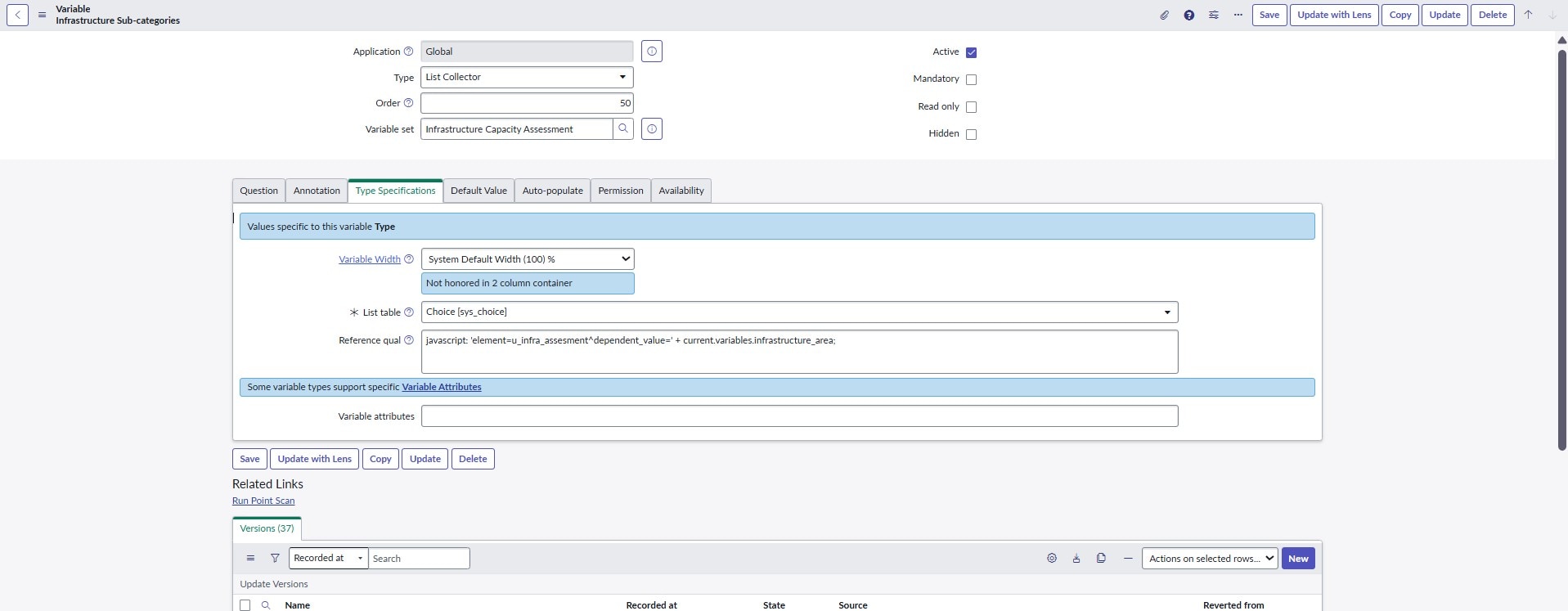

Dynamic Reference Qualifier on infrastructure_sub_categories:
javascript: 'element=u_infra_assesment^dependent_value=' + current.variables.infrastructure_area;
This correctly filters the List Collector's Available options but only reflects the value of infrastructure_area as currently saved in the database, since it's evaluated server-side against current.

For non-catalog tables, the correct formatter to use is 'com_glideapp_questionset_default_question_editor' rather than com_glideapp_servicecatalog_veditor
Secondly, on a variable which has a dependency on another to determine the returned choices, the  'ref_qual_elements' attribute needs to be added in order for the qualifier to dynamically update.
Kieran Anson
