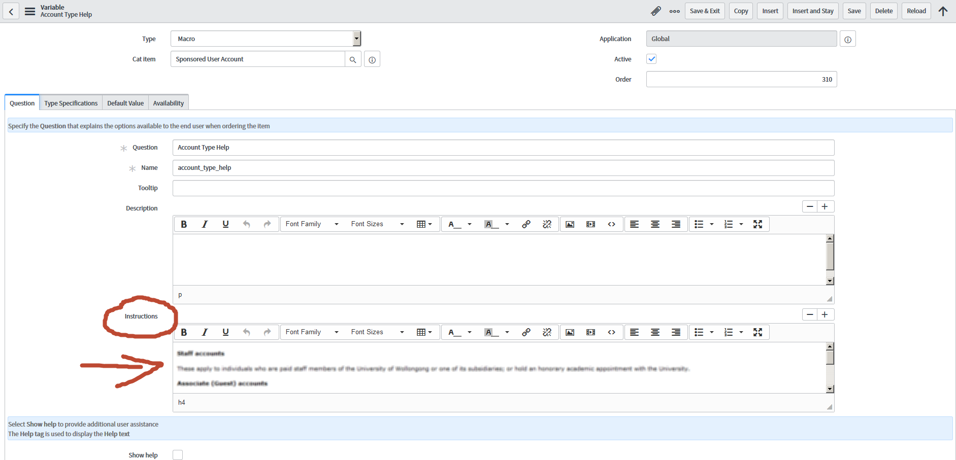

So I built a UI Macro, which gets the html from the instructions field on the variable. This way you only have to have 1 UI Macro to display an annotation. You also get a WYSWIG HTML Editor and as an added bonus its future compatible with service portal! (Because UI Macros dont show in SP, but the instructions field does).

Here a screencap of the UI Macro Variable on a catalog Item and where to put the HTML for your annotation.

You need to get a little creative to make it work.
1. On the platform UI UI macro works.. so use that to show the html text
2. On the service portal macros wont render but instructions field on the catalog variable will work so use that.
Basically a variable of type - Macro with Label which has the macro and instructions on it will work perfectly in both platform UI and service portal.

Variable screenshots
