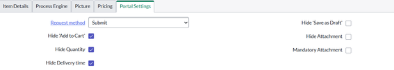

Hi @SATYAJEETJ ,
Switch off the "Hide Attachment" feature and use the "Mandatory Attachment" feature if you want submission of the attachments to be mandatory.
In the catalog item, it will look like this:

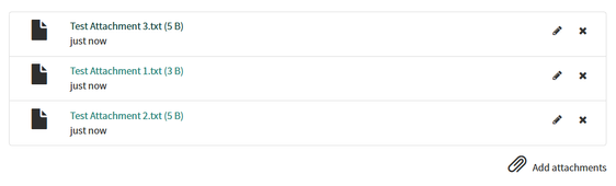

Here you can add multiple attachments and it will look something like this:
