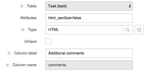

Hello, Yes this still works for me. I have a slightly simpler version of the code. I am using the "Additional Comments" field in this example. I have also tested using a custom field. The attached shows the business rule and dictionary configuration.
Business Rule
function onBefore(current, previous) {
var note = current.comments + "";
var noteWrap = ("[code]" + note + "[/code]" );
var noteStyle = noteWrap.replace(/\<img style\=\"/g, "\<img style\=\"display\: block\; ");
current.comments = noteStyle;
