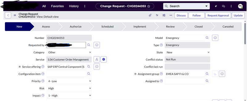

In the Change Calendar dashboard available under Platform Analytics, clicking on a Change event currently routes the user to the Native UI change form.
How can this navigation be changed so that clicking a Change from the calendar opens the record in Service Operations Workspace (SOW) instead of the Native UI?
Is there a supported configuration, URL override, or navigation setting in Platform Analytics / Calendar components that controls the record drill‑down behavior?
please find attached screenshot.
