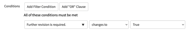

I'm dealing with an unexpected issue regarding e-mail notifications: I configured some e-mail notifications that, once a checkbox changes from "false" to "true", the change would trigger an e-mail. However, this seems to have stopped working. When I checked the sys_email.list, I just can't find the e-mail that's supposedly triggered.
Has anyone experienced any similar issues? If yes, how can my admin fix this issue?

LearnUseThrive
Can we see the whole notification conditions? Is this the "when a record is inserted or updated" condition type? And is "updated" checkbox selected?
C_dric Chen
Hello, everyone. Thank you for all your responses. After further examination, I discovered the cause: It has nothing to do with the True/False fields. Instead, it is caused by the absence of recipients, because their sys IDs (user, user group, etc.) changed after the app was exported from the Development instance to the Production instance.
