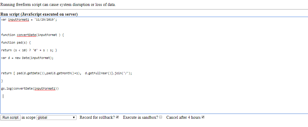

var inputFormat1 = '11/29/2019';
function convertDate(inputFormat ) {
function pad(s) {
return (s < 10) ? '0' + s : s; }
var d = new Date(inputFormat);
return [ pad(d.getDate()),pad(d.getMonth()+1),  d.getFullYear()].join('/');
gs.log(convertDate(inputFormat1 ))
I ran this script in background script and it is converting date into required format.I think , you need to write this code in script include and populate this value into field using client script.

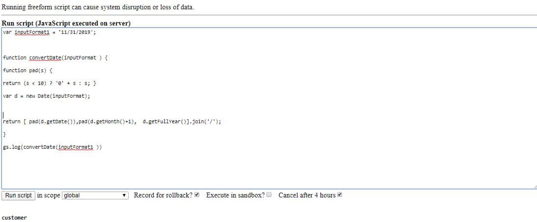

function pad(s) {
