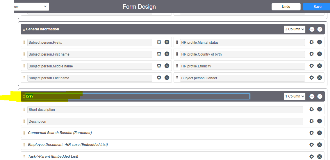

Chander Bhusha1
Hi dmullinax,
Goto to configure -- form Design.
Click on the highlighted part and save the form the section name will get changed automatically.

Chander Bhusha1
Hi dmullinax,

dmullinax
Mega Guru
The name seemed to change on its own after a while, and must have been a caching issue as Jaspal pointed out.  Then after reading CB's reply, I tried opening form design, double-clicking on the form section and I was able to change it from there as well.  I didn't know I could change it from there.
