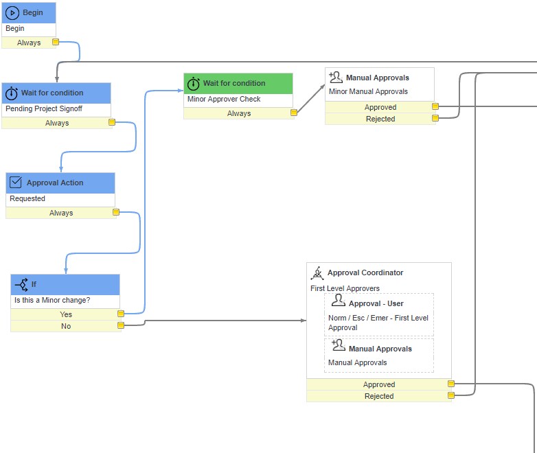

I would be glad to show you what I landed on for this from a workflow and UI action stand point. Sorry it has been so long im sure you figured it out by now but in case anyone else has the same issue .

current.update();
Workflow - The highlighted path is for our Minor tickets which don't automate approvers so we rely on manual approvers being added. The magic happens at the Pending Project Signoff section since its the UI action that moves us to the pending project signoff and the UI Action checks if there are any approvers and if not it will do an invalid update.
