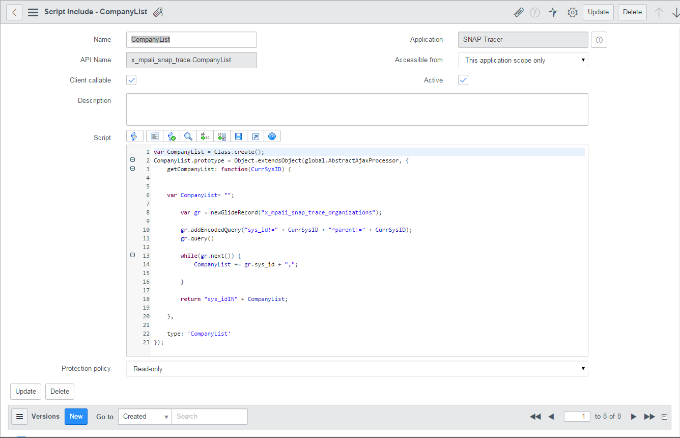

Hi Ahmed,
Here is a screenshot of my script include with my table name in it.
Here is a screenshot of the dictionary entry for the parent organization
As a sidenote, I tried to debug it and it got to the point in the script include where it was establishing a new GlideRecord, and went back to the reference qualifier.
