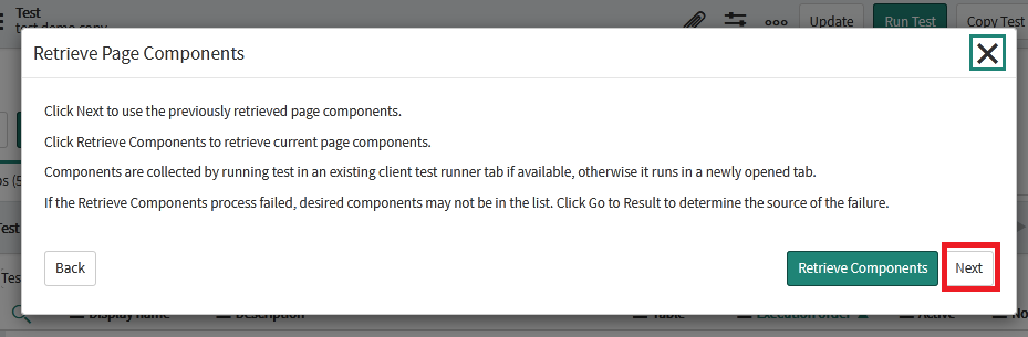

I am writing ATF for major incident.
When I write step to click on Promote to Major Incident ui action, a UI page opens up (shared in screenshot). In test steps , I set field values and then write step as Click on modal button but getting failure summary as 'FAILURE: Did not find GlideDialogWindow or GlideModal'.
Can anyone please help to resolve this where I am doing wrong?

I don't find work notes and business impact. I can see that I have shared in screenshot
05-05-2020 09:18 AM
Hi Rekha,
goto>> sys_properties.list >>check for sn_atf.page_data_capture.enabled
set Value -true
check below screen-shot.
then try to add step--Set component Value(Custom UI)
Hope this helps!
