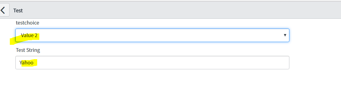

02-07-2017 09:20 PM
It does work for me
//tested
return;
alert('load');
g_form.clearValue('test_string');
var choice = g_form.getValue('u_testchoice');
alert(choice);
if (choice == 'value_2') // value_2 is the value of the choice
alert('inside');
g_form.setValue('test_string','Yahoo');
Harish
