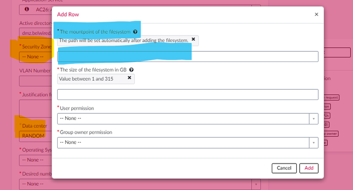

Hi all,
I have a catalog item request with few variables like 'security zone' and 'data center'. Then I have also a MRVS that has a variable 'the_mountpoint', and I want this variable to be populated with values from those 2 fields, however it seems g_form.getValue() is not working... Any solutions?

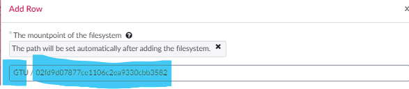

Hi Brad,
This indeed helped. I can populated the field with the values however one is getting me the sysID as the value comes from a reference table.
What can I do to get the display value? I tried getDisplayValue() method but seems not to work:

The easiest thing to add to the script is a GlideRecord on the reference table.  Use the value retrieved from the parent as the sys_id / record to retrieve, then use the Name field or whatever from that record to populate the MRVS variable.
