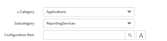

this did not work...I created the "onchange" script using the script provided.   the fields look to be correct 'subcategory' and 'cmdb_ci'
I opened a new incident, set the category to applications, then I set the subcategory to "ReportingServices" which is a "business service" we use often.

Here's the Business Service I'm selecting from that choice list that matches
Alerts Appeared but no value set
first alert failed for some reason, cant you double check the field name?
