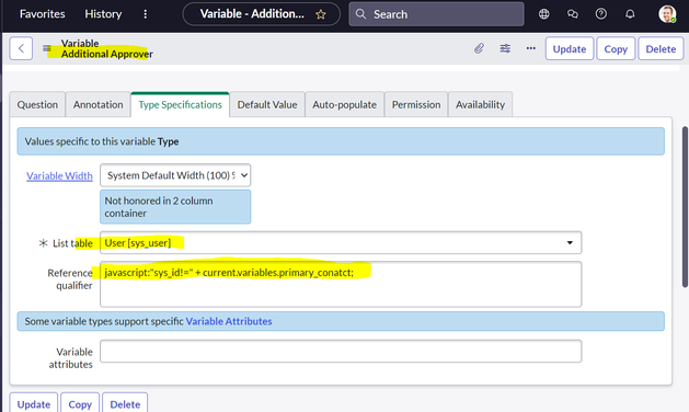

My suggestion will be to write reference qualifier on "Additional approver" variable so that User selected in "Primary contact" will not be available in "Additional approver".
Please find below solution :
Reference qualifier : javascript&colon;"sys_id!=" + current.variables.primary_conatct;  //you can use your variable name here for primary_conatct

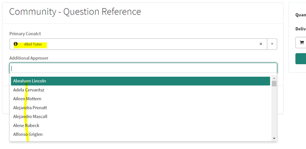

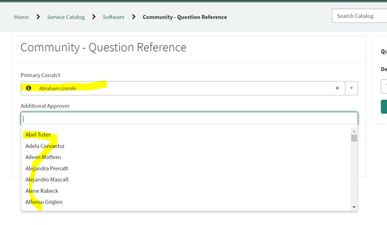

Please find the output I'm getting
1.Test case  : If I select "Abel Tutor" in primary contact  then I'll not able to see "Abel Tutor" in Additional Approver
2. Test Case : If I select "Abraham Lincoln" in primary contact  then I'll not able to see "Abraham Lincoln" in Additional Approver
This approach will reduce the effort for writing complicated custom script.
I hope this will solve your problem.
Vishal Birajdar
ServiceNow Developer
- Socrates
Hey Vishal,
your proposal works like a charm! Excellent.
