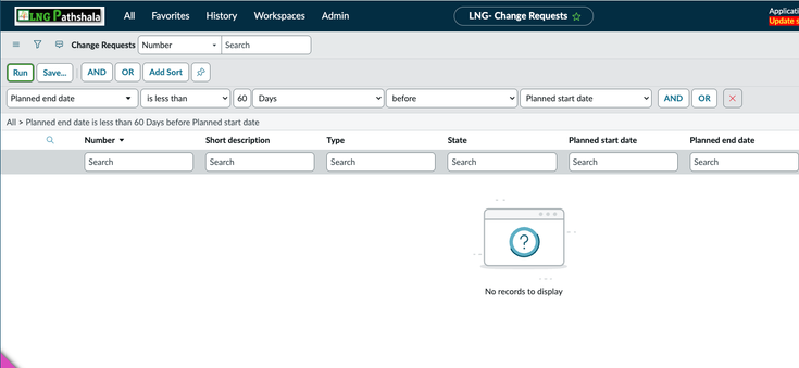

01-30-2026 04:31 AM
I am trying on change record:
try similar for value.
01-30-2026 04:49 AM - edited 01-30-2026 04:51 AM
Hi @Dr Atul - LNG
The Planned End Date is a date-type field, so you can use it. However, in my use case, the 'Value' field is a string type, which is why I can’t use before like in your Change Request example.
That’s why I need a condition.
