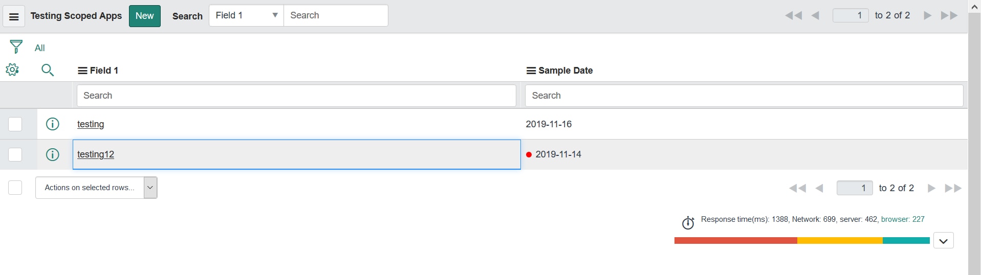

use this and it will work; I have applied the color to same field i.e. the date
you can give your custom field as well;
I can apply color to Field1 based on the Date value as well
give value as below
javascript: new GlideDateTime(current.avventer_svar_innen) < new GlideDateTime()
I tested this in my scoped app table and it is working on list
