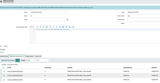

I'm currently facing an issue with ServiceNow Discovery for our Fortinet equipment. While the discovery process is working for our FortiGate devices with the Fortinet Core mib file I'm using, I'm struggling to get it to recognize our Fortinet Access Points (APs) using the provided Fortinet AP mib.
At first, after loading the mib file and running Discovery, I was getting "Active, couldn't classify".  When I dug into the payload, I could see that the OIDs are actually being pulled. Now, after creating a new SNMP Classification and adding the oids, the APs are being classified but no CI is being created. Even after discovery has finished it remains in the stage "identifying"

  3. SNMP Classification: I've created a new SNMP classification named "Fortinet Access Point" on the "Wireless Access Point" table. I've also added the OIDs for the Fortinet APs based on their sysObjectID.
