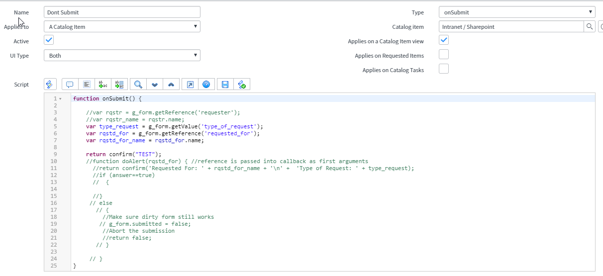

I am trying the same thing and return confirm () isn't popping up in the portal for me.   My UI type is already set to Both and I've commented out everything possible.   This works fine in the ITIL backend view, but in the portal nothing pops up:
Hi Steven,
The above was on a record producer, but I do have a popup box on a catalog item that is working.
I think you might need the IF statement in place before the return confirm so it knows when to produce the popup message?
