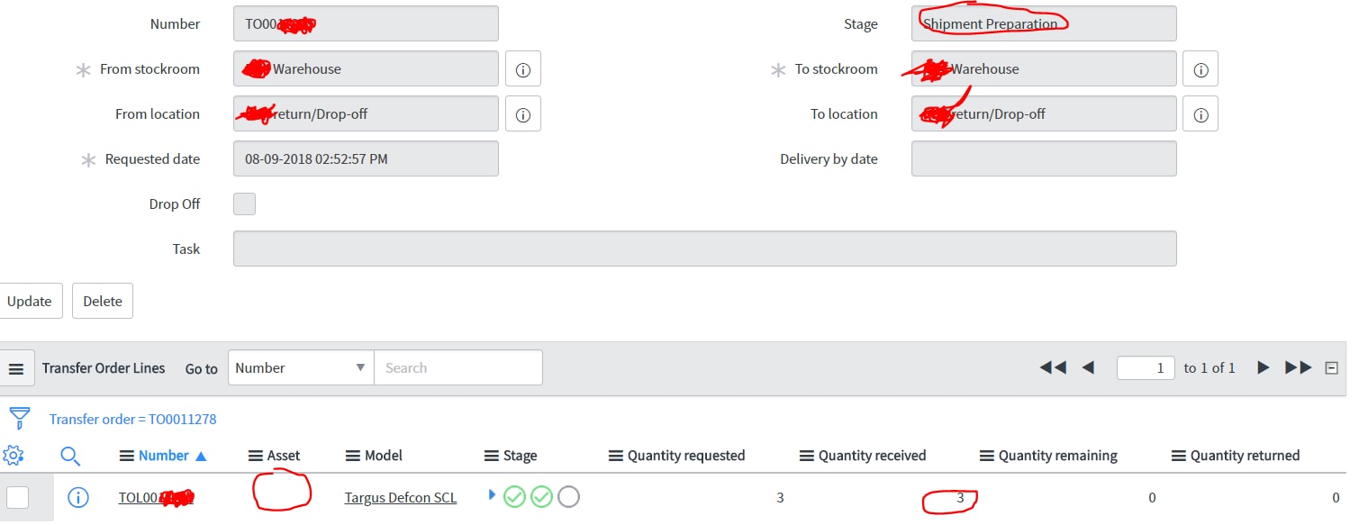

Case (1) Consider the Transfer order on a consumable within the same stockroom as shown below:
In this scenario: "Ready for fulfillment" option is available, also the consumable asset is attached to the Transfer order line (marked the areas that are crucial for Transfer order in RED)
Once "Ready for fulfillment" button is clicked... the TO goes directly to received state as shown below, Asset is removed from the Transfer order line and merged with existing "In Stock" and "Available" records as opposed to modifying the state to either "In stock" - "Pending install" or "Reserved"
1) If Asset is removed from TO (as shown in above picture) how would you track which consumable asset related to that TO
2) Consider if "Service Desk" team deploys the consumable to the user or with an asset, how will he/she change the status on the asset that was supposed to be linked to this transfer order
We cannot expect end users to go into the model and then Consume the required consumables.
