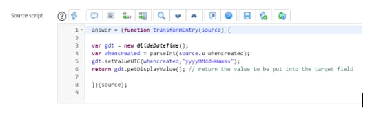

Context: Using a Transform Map, I am importing Active Directory (AD) data into a ServiceNow CMDB table.
Requirement: Convert the field value of' 'WhenCreated' (from AD) to a Date/Time format (in ServiceNow).
Sample value of 'WhenCreated' = 20181107064109.0Z

Now, I would like to use this script to run on a "Field Map" in the Transform Map
so that the target field is updated in 'Date/Time' format. I tried the following script with no success.
Could you please help me in correcting the script ?

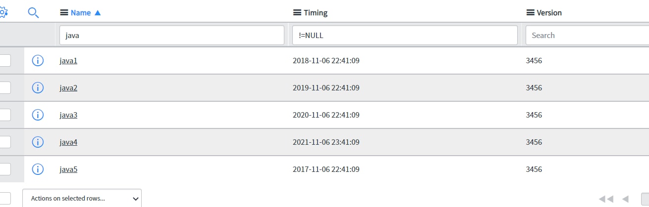

I tried same scenario using data source and import set and its working
data source:-
Transform map field script
It works as you see below it created in the table.
data type is date/time for timing field i created just now.
check you code , if issue persists, try using logs to see what is wrong

Hi Anshu,
Thanks very much for the quick response and verifying the script that it is working for you. I corrected my code as per your script and tried running the transform map, but no luck.
I am not sure if the field type on the target table may be causing the issue for me. My field type is - Date/Time.
What is the field type you set for your 'Timing' column?
