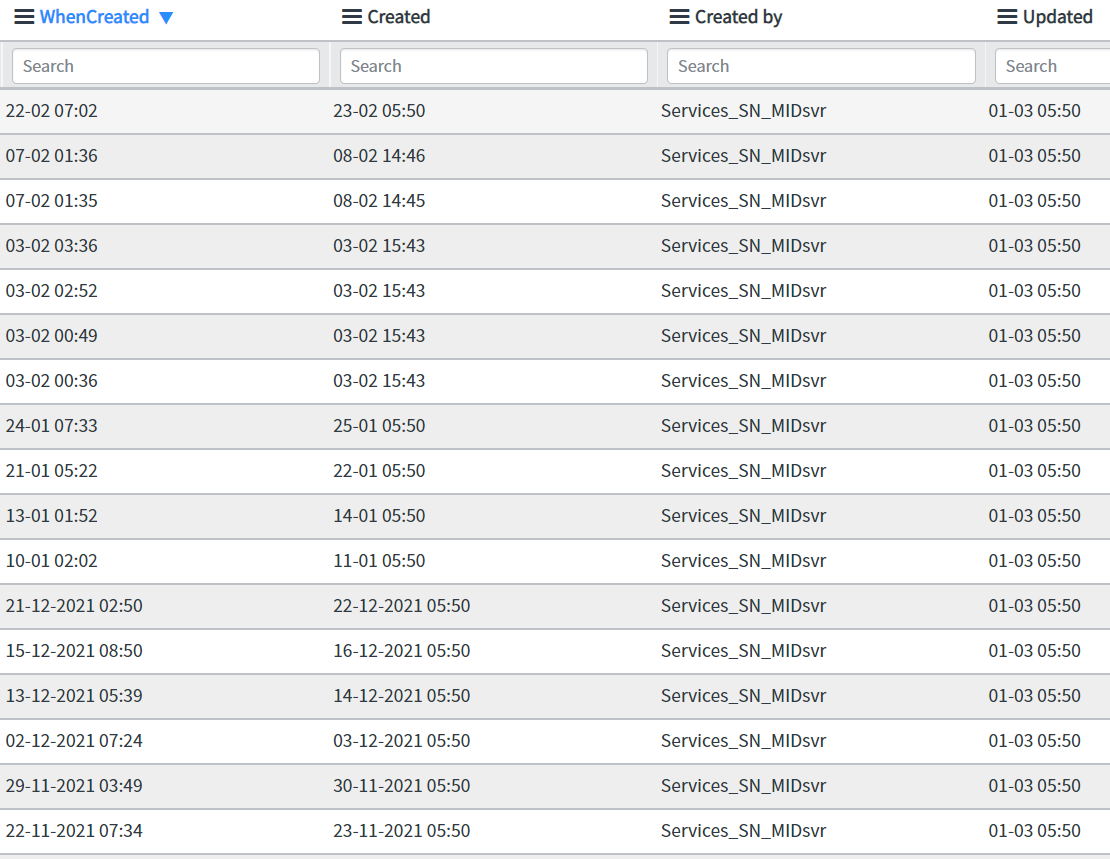

02-24-2022 02:10 AM
I tried same scenario using data source and import set and its working
data source:-
Transform map field script
It works as you see below it created in the table.
data type is date/time for timing field i created just now.
check you code , if issue persists, try using logs to see what is wrong
If this is helpful, mark answer as correct
02-25-2022 01:12 AM
Your log says updates 425,
It means it updated the 425 entries because all the record already exists from previous imports.
Its not creating new ones as its updating each record by matching the fields.
Try to first clean/delete the records in that temporary source table then import and execute the transform map
