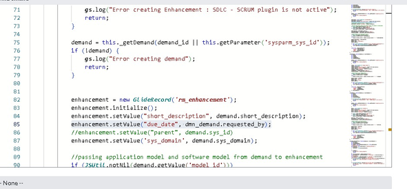

I'm trying to accomplish with a client requirement. They need to move the date of due date field in demands to the due date field in enhancement. Field specifications are as follows:
Due Date Demands:
  • table: dmn_demand
  • type: date
Due Date in enhancements:
  • table: task
  • type: date/time
In order to move this value from demand to enhancement I have modified the script that create enhancements from demands with this statement:
It seems to work correctly but there is a little problem that you can check below:
Demand:
Enhancements
You can see how enhancemetns takes the previous day at 17:00 to the one I put in demands
Is there anyway to adjust this in order to get the same dates in both fields?
