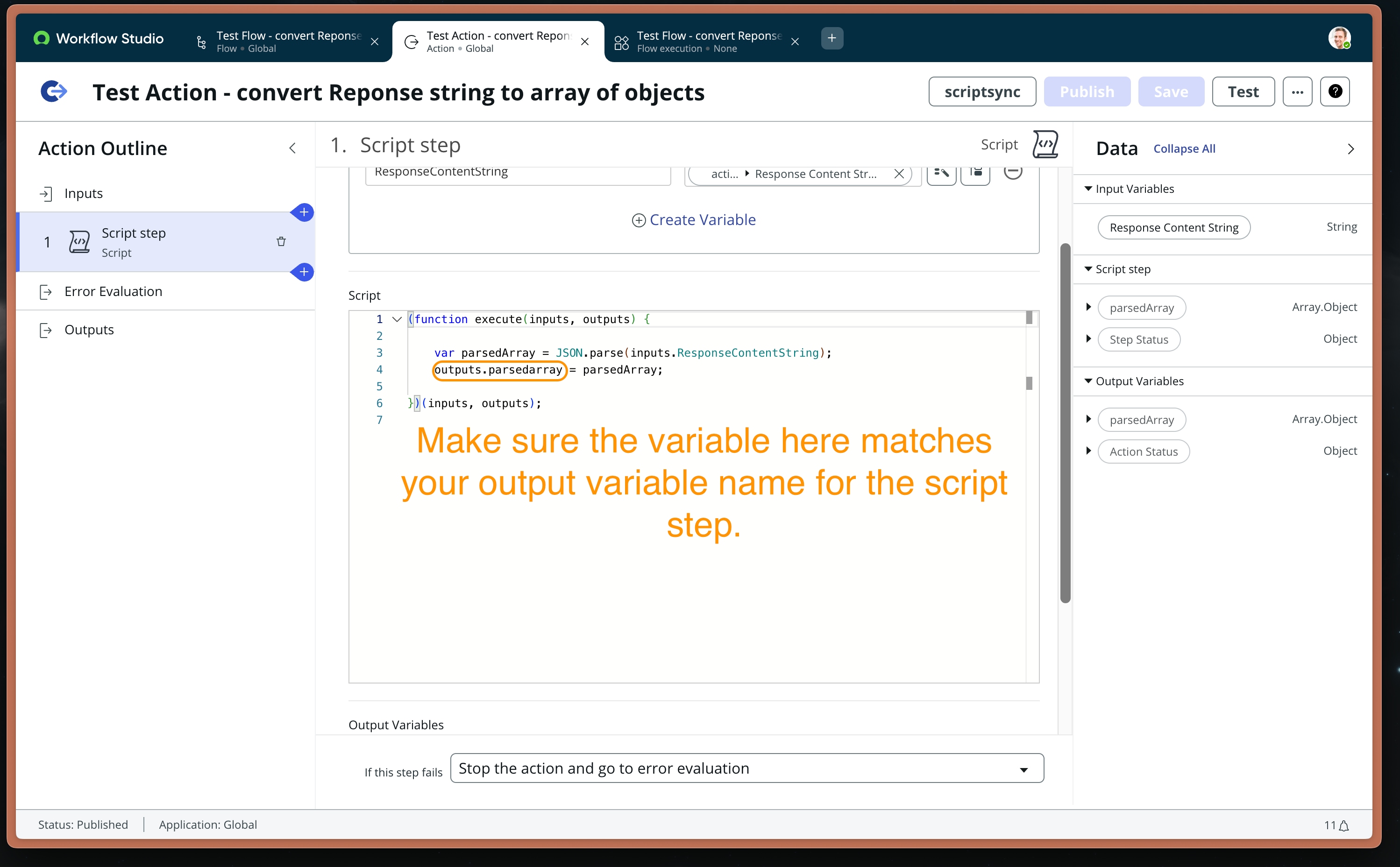

hi , I am working with API and I get my response content as shown below .. how do i use script in Action flow designer to convert to Array of objects ?

This should be working based on my testing with your provided JSON example.
I think the issue is in your script. You have "outputs.requests = parsedArray," but according to your screenshot, your output variable is named "parsedarray. You script should look like this instead:
    var parsedArray = JSON.parse(inputs.ResponseContentString);
    outputs.parsedarray = parsedArray; // The name of the variable for "outputs.<name>" should match your step outputs exactly.
})(inputs, outputs);
It might be useful to use more distinct names for your variables and outputs as that might be causing a little confusion. So instead of parsedarray for your step output, maybe something more like Employee Requests [employee_requests].
See attached for examples of what I tested.

Thank you , i tried as suggested above , but I still get null output response. I am attaching screenshots for reference.
My goal - I get a string which contains a jsonformatted value. I want to convert this to array of objects so that I can use for loop to iterate each child in array  outside the action in flow designer .
gopijasti
Excellent ! Thank you very much Zach ! appreciate your time and clear explanation ..
