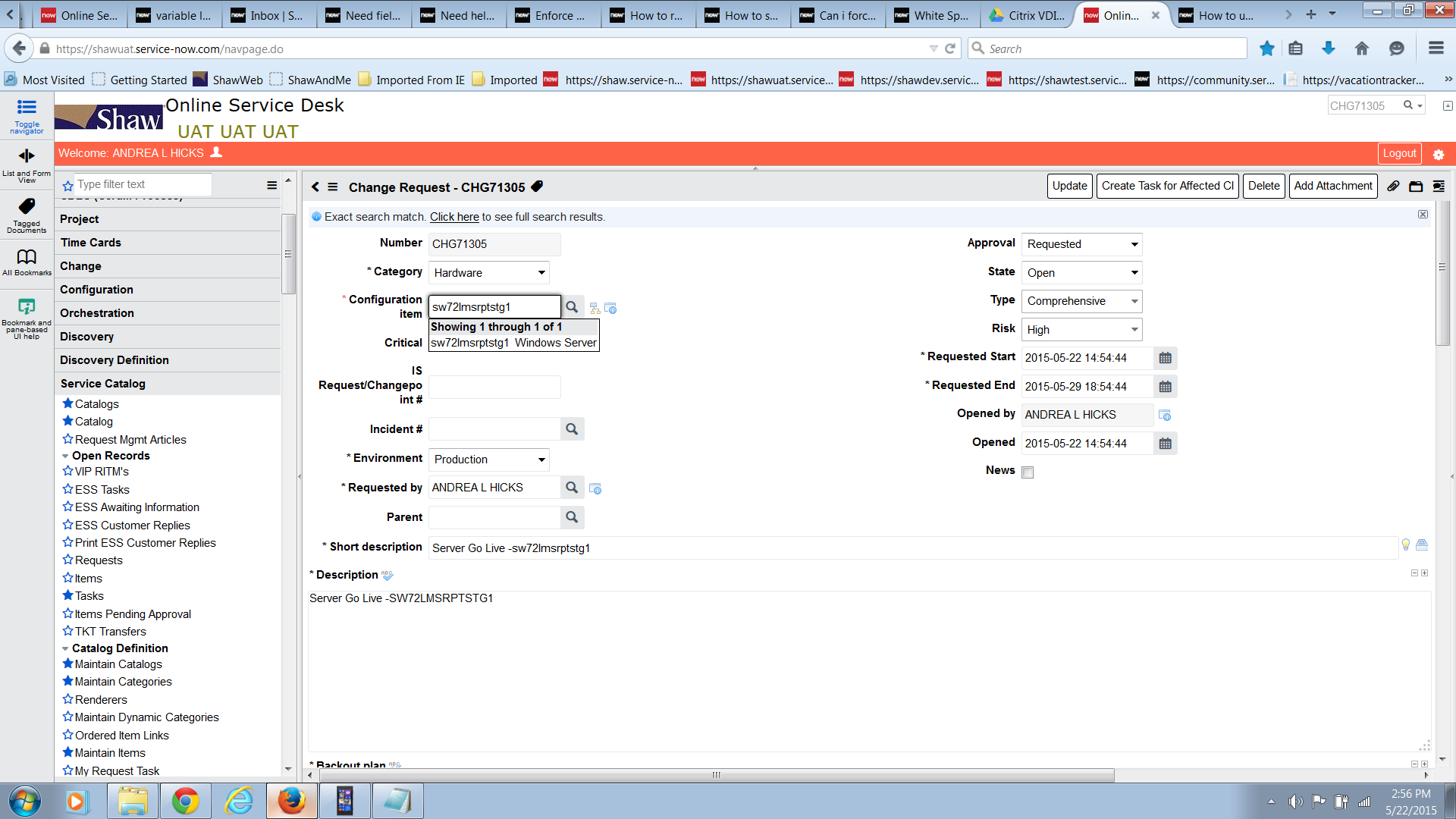

Here's what it looks like.
We'd like to populate the server name in lowercase, but it forces the uppercase server name they enter on the
record producer.   Like what's in the description.
