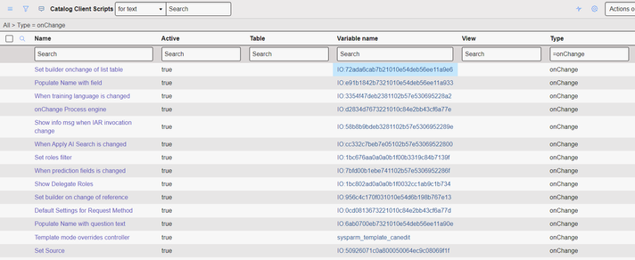

Not the script type. You need to select another variable name onChange of which this client script is running and then revert that back . Reason being system stores sys_id of the variable and its still storing the sys_id of the variable that is part of the old variable set.

Try to switch the onChange field to other field and then save . then reselect the previous field and check if its working.

changed it to onload saved, then to onchange again. Did not work

i see mye new catalog script hs not gotten a variable name
may this be the issue,
