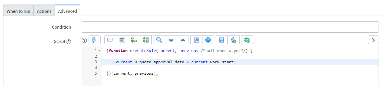

01-13-2022 03:50 PM
You can do this to set when to run:
The table sc_request extends sc_task then you're working with fields of the same table.
Since you're working on the same record, your script can be as simple as this:
Please mark my response as Correct or Helpful, if you find it appropriate.
