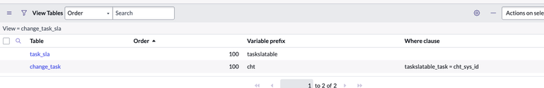

OOTB DB:
https://INSTANCNAME.service-now.com/now/nav/ui/classic/params/target/sys_db_view.do%3Fsys_id%3D6529424f0a0a0b4b00d66243f6fdf859%26sysparm_record_target%3Dsys_db_view%26sysparm_record_row%3D8%26sysparm_record_rows%3D192%26sysparm_record_list%3DORDERBYname
