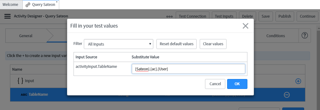

I have built the necessary JDBC connection, credentials and also created the JDBC activity; the connection and credentials were validated and tested successfully. When i try and test the connection on the activity, the message displays as: "Connection looks good". But when i test the inputs, i get the following error message:
I have modified the MID server to accept all IP ranges, included the capability JDBC, included ALL and Orchestration in the mid server supported applications; but still i am not able to proceed beyond this step. I had created the following test inputs:
The Execute command section is as follows:
Can you please suggest me steps on how to rectify this error or finding the root cause of it; also if possible, provide further significant steps to follow. Many thanks in advance.
