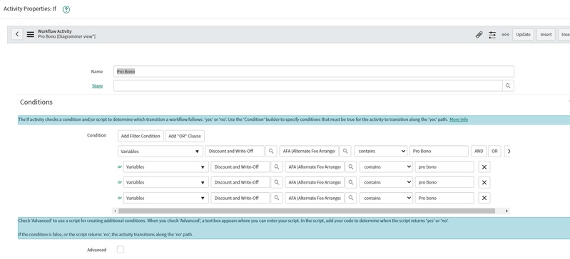

Hi everyone,
how can i program this better, i want to be able to convert the string into lowerCase and then search for the lowercase sub sting in the If Statement
If condition updated.
make sure the variable afa returning string type value [ not an object type ]
in case, afa is returning Object, then add .toString().toLowerCase();
answer = ifScript();
var proBono = current.variables.afa.toLowerCase();
function ifScript() {
if (proBono.indexOf('pro bono') > -1 ) {
return 'yes';
return 'no';
Please mark this response as correct and helpful if it helps you can mark more that one reply as accepted solution
