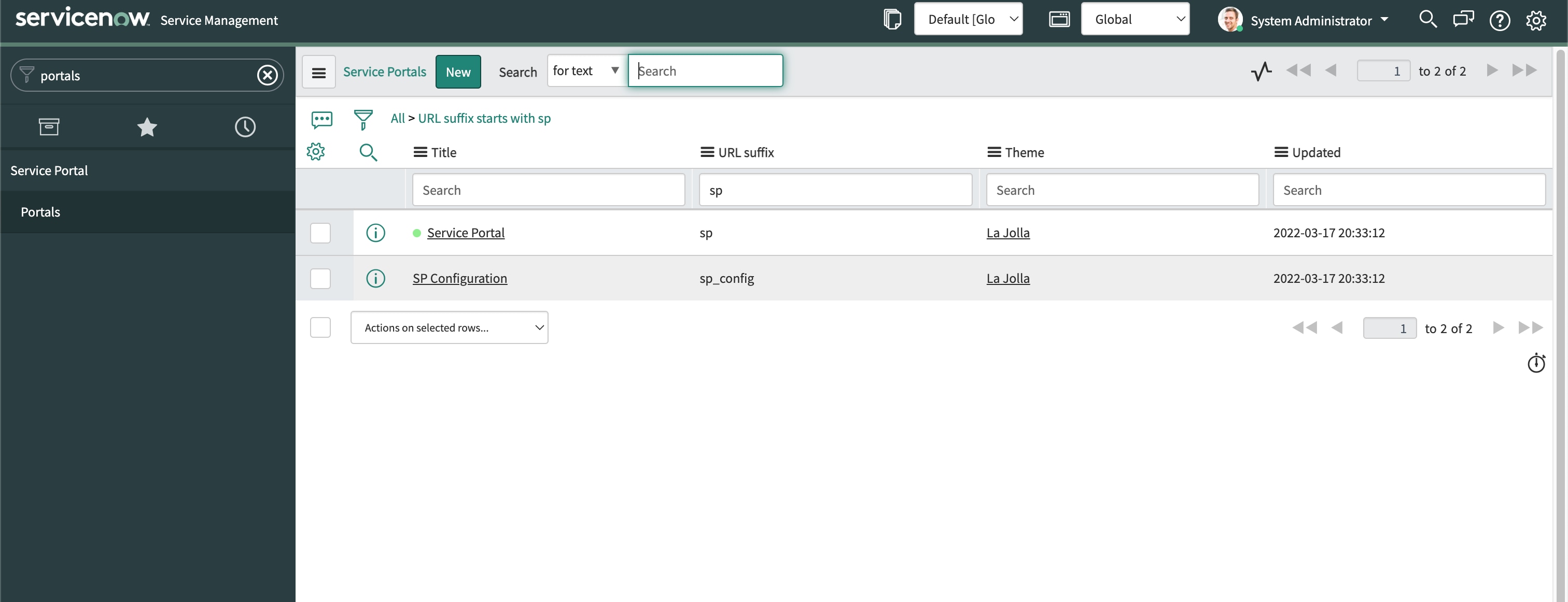

1)Type in portals and click on portals
2)Open your portal record and open the record tagged in main menu field
3)Create a record in main menu table after opening that record

hello @Lam Thai Duy ,
you can follow these steps
