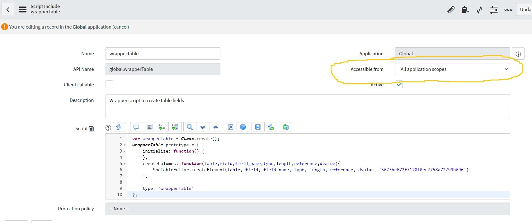

Hi all,
I have figured out how we can use (SncTableEditor.createElement) method to create fields in a table. Now the problem with above Glide method is that it dosen't work until you modify global dictonary table and give access for Can create & Update from all application scope.
However the method (SncTableEditor.createElement) works fine if you want to create fields in a table in global scope but not in costom scope. To resolve this issue, you need a script include in global scope in which this method will be written and then we call this script include in our custom scope.
Below is script include with some parameters in the method:
Note: Create script include & set accessible from "All application scope".
Now call this script include in any custom app scope like below:
var warraper = new global.wrapperTable();
warapper.createColumns(*pass parameters here*);
The above method last parameter is scope. You need to pass sys_id of your scope.

03-25-2023 04:19 PM - edited 03-25-2023 04:38 PM
This is a great help, thanks! 😁 A couple things to note:
- The 'dvalue' stands for the default value.
- I've taken the global script includes one tiny step further and allowed the scope to be passed in:
var wrapperTable = Class.create();
wrapperTable.prototype = {
initialize: function() {
createCols: function(table,field,field_name,type,length,reference,dvalue,scope){
SncTableEditor.createElement(table, field, field_name, type, length, reference, dvalue, scope);
type: 'wrapperTable'
- There is a typo in the scoped calling script in the post above: 'warraper' and 'warapper' (in case you copied it like me and got an error). Another way to do it is in the screenshot below. For testing purposes, you can put the script below in a fix script and run it manually to see it create the table column.
var col = new global.wrapperTable();
//table, display field name, internal field name, type, length, reference, default value, scope
col.createCols("x_table_name","First Name","first_name","string","40","NULL","","84dd56a547312110bf05249bd36d4aa4");
