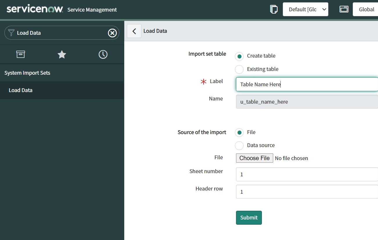

Below are some screenshot which may help you get started:
Now within transform map select your Target Table where you want to upload data to and then click on Auto Map Field Map related link as shown below. This should define your field Maps if not then manually define it by clicking on New and then select Source and Target fields as shown below:
Once this is done, make sure to choose a coalesce as well to avoid duplicate record transformation within your field map.
Click on transform.
