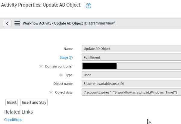

I know you said you can't use the OOB Update AD Object, but you can set Account Expirations with it. We use it to activate vendor accounts in our environment (people who aren't here all the time):
But with relation to your current issue...I ran into a similiar situation the other day and I had to set my script to a variable then dot walk to the name field I wanted.
