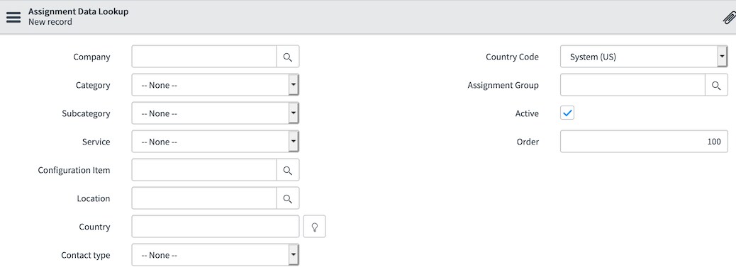

We have a lot of data but you don't need to use every field in every definition.
Here is screen shot of our lookup record:
and the lookup definitions:
