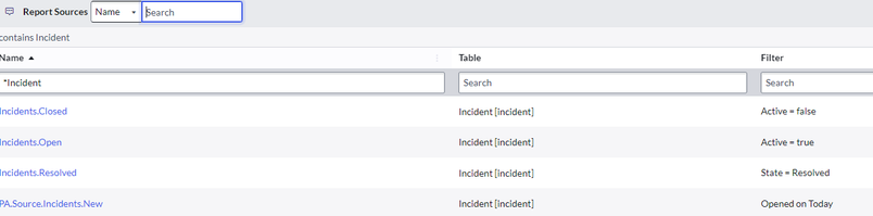

Your data source is stored in the table sys_report_source_list.
The reason for this is, if you share editable rights to a report, then users can edit conditions if the conditions is build directly on the report, but not if they are build into report sources:
Data sources should not be shared with users, only reports should be shared with users.
