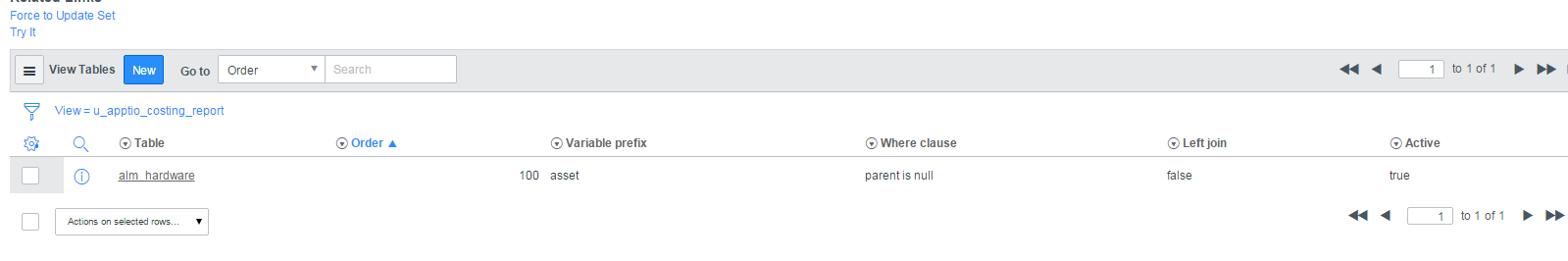

I'm trying to produce a database view using the a where clause to the effect of (WHERE [field] IS NULL). There's no documentation on this on the wiki for this so I'm hoping to find some experience with this within the userbase.
As a test I'm trying to create a view of alm_hardware, where parent is null. When I execute "Try It", the page refreshes and I'm actually sent back to the list of database views, indicating that some error occured but isn't displayed.
My error log found in the system logs is :
java.lang.StringIndexOutOfBoundsException: String index out of range: -1
Caused by error in Script Include: 'ViewUtil' at line 22

Attached is an example of my view.
