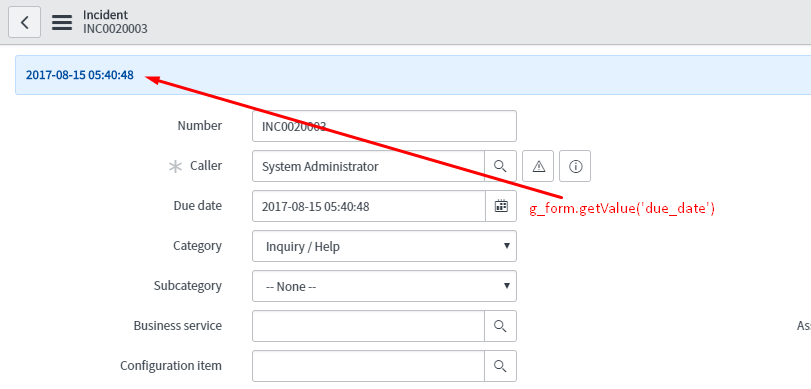

Some of this depends on how you are accessing "When needed". If you are pulling the value with a client script and sending it to the server with GlideAjax, then you expect it to be sent as whatever time zone the user is in.
If you are accessing "When needed" from the record using a server-side script, then you expect it to be expressed in the UTC time zone.
See these screenshots for an example. In this example, my local time is 2017-08-15 05:40:48, and it appears as such when I pull the value with a client script. If I access the same record from the server, I would get 2017-08-15 12:40:48 because that's the database value in UTC.
So...does that help? It depends on what strDate is coming from, and that can explain why it's different than you expect.
