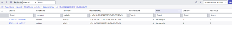

If you do not want to write business rules or capture this information on update of priority, then it is little tricky. you can use sys_audit table, but it will be performance intensive. The sys_audit table stores everyupdate of the field (if audit is enabled on your table). Since you are referring to incident table, just go to sys_dictionary and there check for incident tabe and see if audit checkbox is true or not. (ref: https://docs.servicenow.com/bundle/tokyo-platform-security/page/administer/security/task/t_EnableAud...)
Once that is enabled, then you can go to sys_audit table and from there you can know when the value is changed. Look at this screenshot below to get an understanding of it.
In this you can see oldValue and newValue. Based on these fields and created by, you will know when the change has happened. Hope this helps.
