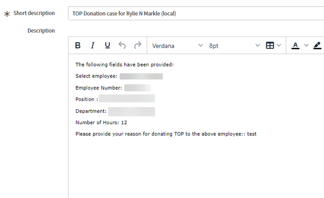

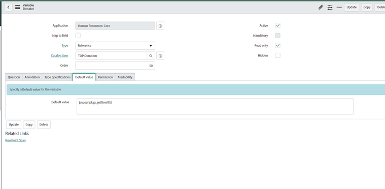

I have a variable on my record producer that I want to default to the current logged in user's name. I have it set up to default, but I can't get it to show in the case description after submission. Is there a way to do this?

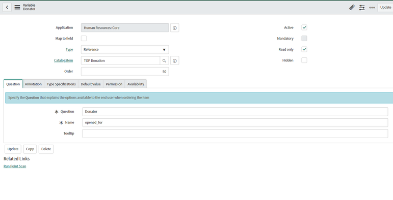

Good question and I'm just pointing to the documentation, but after looking at the actual scripts related to this, it appears that there's just 4 that are ignored: opened_for, priority, short_description, description. So other variable names may actually end up in the description of the case.

Sorry, I should have been more clear. The entire field isn't showing up in the description. I want it to say "Donator- Employees Name" but there isn't even a line for Donator.
All of my other variables and their values are showing up fine.

Per documentation, since you've named the field "opened_for" which matches an HR case field, the logic is to skip that and not add it to the description: https://support.servicenow.com/kb?id=kb_article_view&sysparm_article=KB0993578
You can change the variable name and it should work as you'd like or...you can change the behavior of the process to add it to the description even if it matches an HR case field, but I wouldn't recommend that.

I just can't change the name because I have a catalog client script that uses the opened_for user to populate another field on the RP.
