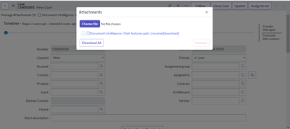

I have a requirement to "disable/make it read only" the 'remove' option for Custom table please refer the below screenshot.
And I tried creating the Delete ACL on sys_attachment table with condition as "table name is <custom table name>" and script as if(gs.getUser().hasRole('admin')){
answer = true;
}else{
answer = false;
But still not working Is there anything I should update for this in order to work.

@Ankur BawiskarI did Debug security rules but no ACL's were showing up in the debug screen most of them are angular

@Tushar We cannot use current.table_name in the condition as its a dropdown filter.

@Ankur Bawiskar Any solution for this to restrict the Deletion of the attachment for non admins on a specific table?
07-31-2023 05:32 AM
if the user has write access to your table then user can add/remove the attachment
Why not use before delete BR on sys_attachment table then?
