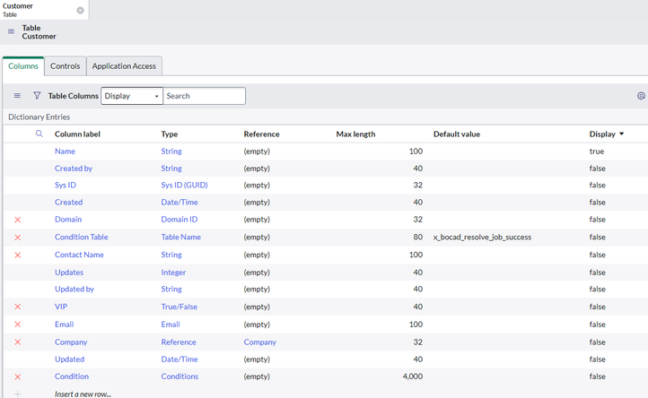

I have the following table, it has a name field with the display column set to true, all other fields have the display column set to false:

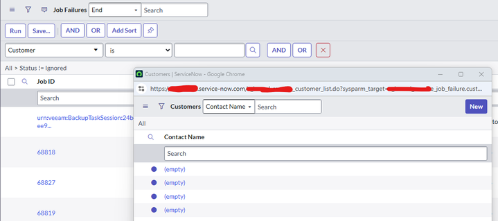

When building a condition from another table that references the customer table, the contact name field is being displayed:
I thought this is what the display field was for? I've checked to see if there are any dictionary overrides, there are non. Any ideas?

The Display field is what will show after you select the record in a Reference field. To change the view that shows in the pop-up, just right-click on the header of the pop-up list and select Configure -> List Layout and select whatever fields you want to show.

12-02-2024 09:13 AM
You likely just have to modify the list layout of the pop-up reference selector to display the columns you want. Sometimes ServiceNow glitches and displays the wrong field. Once you Configure > List Layout, you'll be all set.

Hi @Community Alums ,
1. Right-click on contact name column the header of the pop-up list in the reference field and select Configure > List Layout.
2. In the List Layout configuration, add the Name field (or any other desired fields) to the Selected list to control what is shown in the pop-up view first.
Mark it as helpful and solution proposed if it serves your purpose.
