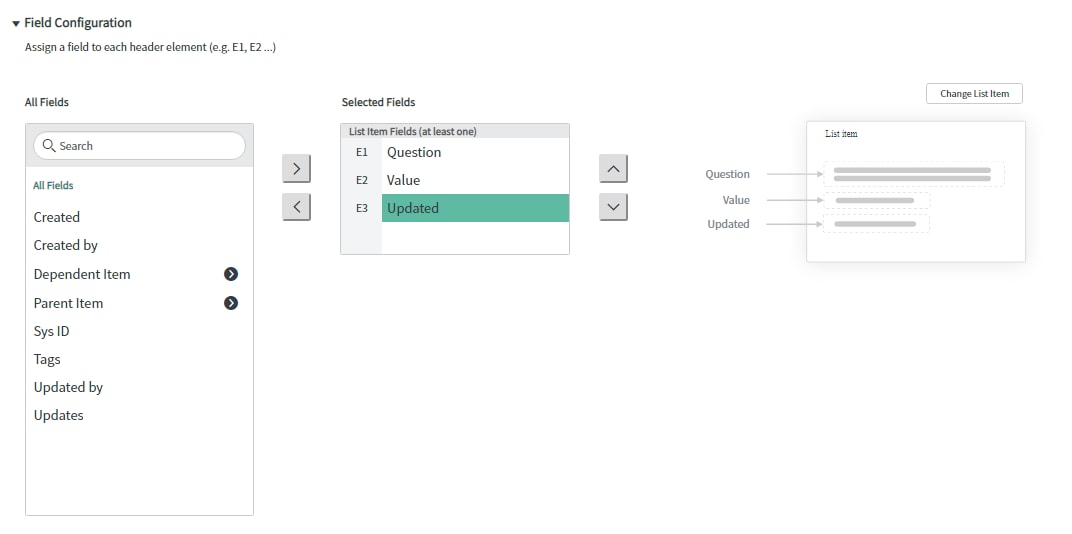

You will want to make a new Data Item configured like so:
It doesn't really matter what you name it, as long as you remember what it is. I like to name things what they are, so I just stuck with the table name for this demo.
From here, you need to make the Applet, or Screen, that you will view this data from. I configured mine like this (for demo purposes):
We won't use Autofill, and notice that we have the display turned off, this is important.
I'll leave the data display up to you.

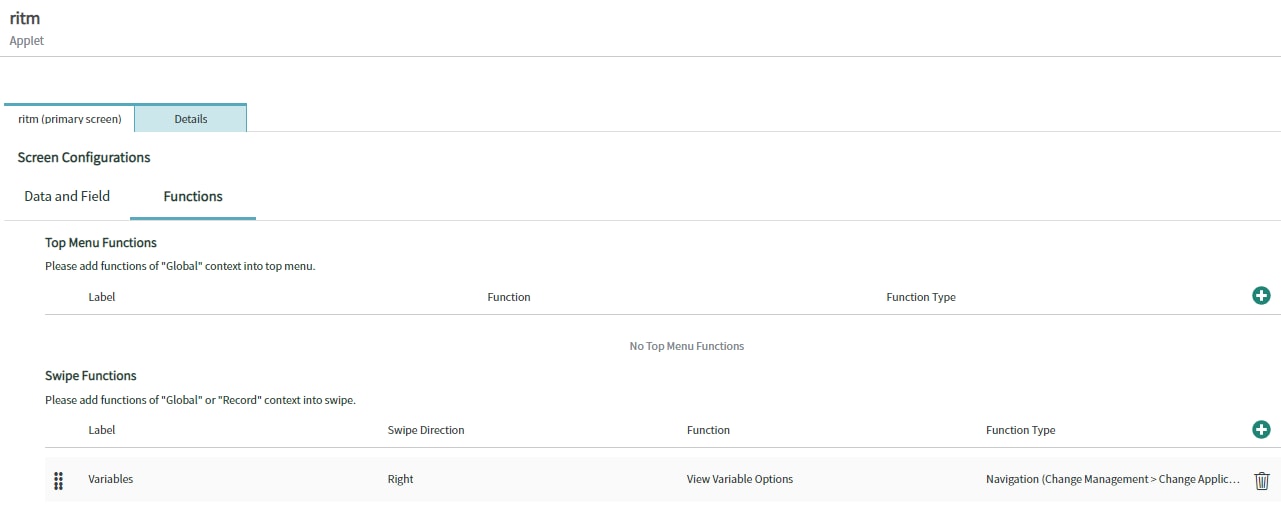

After you have created that Applet, you are going to want to link your RITM applet (you could use sc_task as well I assume, you'll just have to dot walk a bit to get to the RITM sys_id) via a navigation. Make a new Navigation and configure it like this:
Now you have a navigation that will go from the RITM, and auto fill the sys_id of it into our sc_itm_option_mtom screen, which will then only display options from said RITM.
To add this to your RITM list, you will want to go into your RITM applet (or possibly a sc_task applet with some dot walking to display RITMs) and add either a swipe function to the primary screen with your navigation (will only work if your primary screen shows the RITM) or as a function on your details screen:

First off, you will have to start with the table that those options and values exist: sc_item_option_mtom
