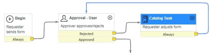

Scenario:
I have 2 users involved, a Requester and an Approver.
  1. At "Begin" the Requester applies by filling in data in a form from the Service Catalog and sending it to an Approver:find_real_file.png
  2. The Approver receives the approval request, checks the content in the form, and rejects with a comment:find_real_file.png
    The first time the workflow runs through this point, I am able to copy the Comments of the Approver to the Requester by putting this script in the Catalog Task. However the second and all following times the workflow passes this point, the script does not work anymore.
    Q: Does anyone have an idea how to forward/copy/display the Approver's Comments to the Catalog Task after the first cycle?
  3. The Requester gets a Catalog Task assigned to, adjusts the data in the form accordingly, and sends (by closing the task) the application with a Work Note back to the Approver:find_real_file.png
    I found a method to set Comments into the 'Approval - User' request, but I'm unable to get the Requester's Work Notes from the Catalog Task. I simply cannot "find" them.
    Q: Does anyone have an idea where/how to "find" the Requester's Work Notes from the Catalog Task?
