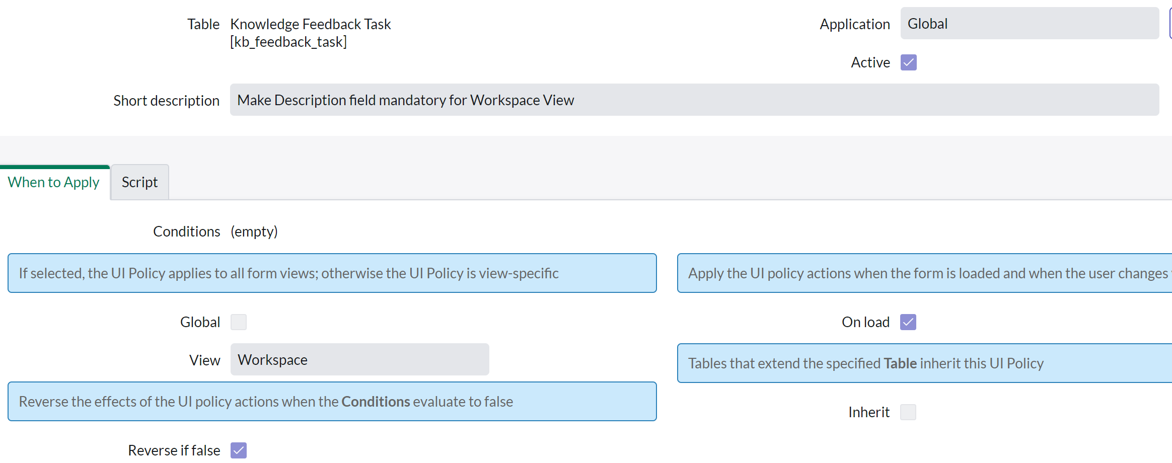

UI policies work in workspaces. check if your UI policy applied to your workspace view
example
Ahmed
Please mark my answer as ✅ Correct / Helpful based on the Impact
Hello.
If I checked the "Global" box, should I uncheck it?
