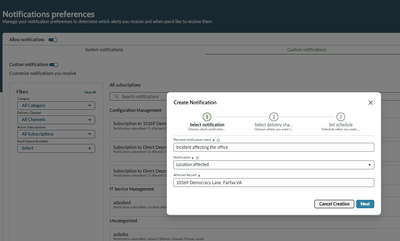

Might be you are actually struggling with the subscribable notification. So, how to trigger the notification?
- It is a subscribable notification so you need to subscribe to it [sys_notif_subscription] by using the notifications preferences experience for example
- When you are testing it notice that the email is set to not send to event creator so if you update the incident you won't get the notification OOB

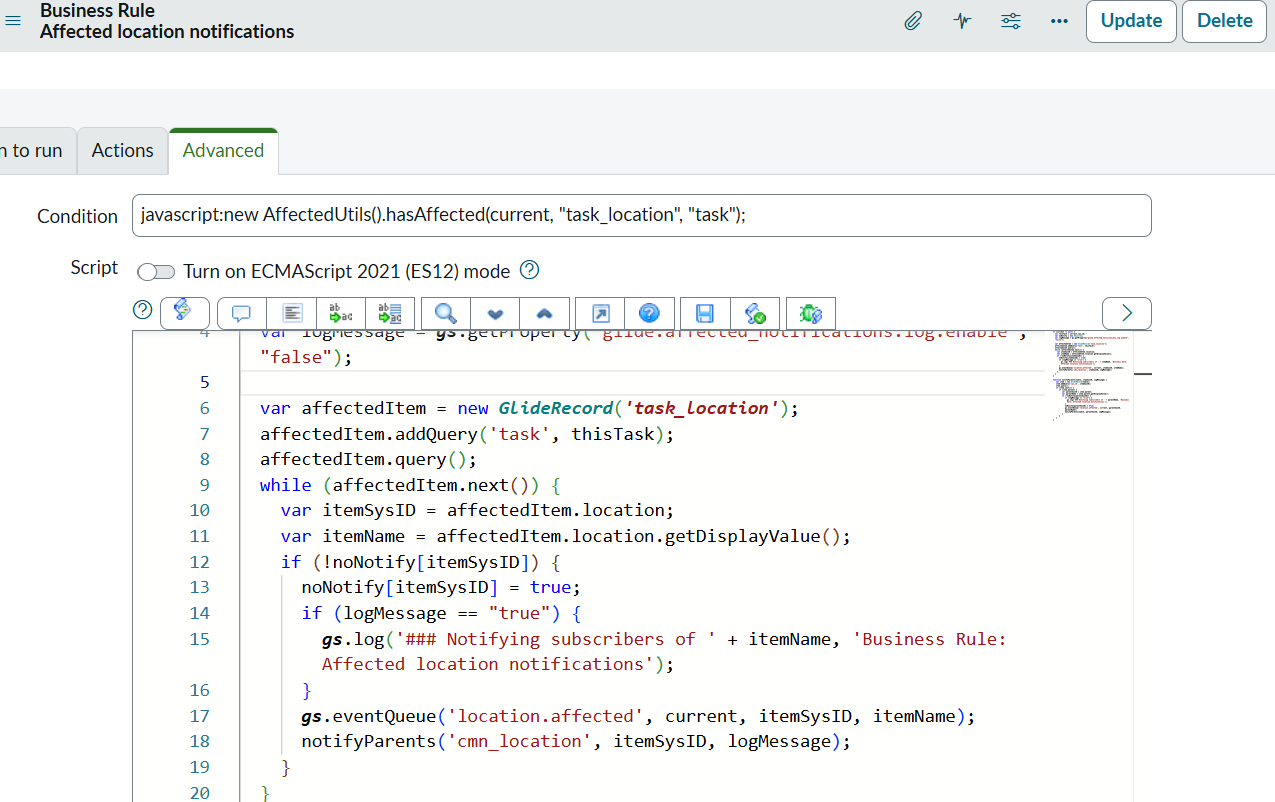

Hello @jamesbet23
Notification Name: Affected location notifications
Trigger Condition: javascript:new AffectedUtils().hasAffected(current, "task_location", "task");
It means if this task have any related records in the "task_location" table?
then it triggers the Business rule and then notification
02-16-2026 09:07 PM
The br "Affected location notifications" on task
/sys_script.do?sys_id=0a7daca70a0a0b1d00b156b6b953267b
