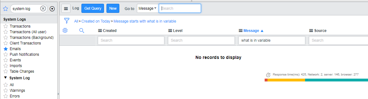

I inserted the updated script and ran a couple request thru. When I search the message column for what is in variable, it is not finding anything.
07-16-2017 09:18 PM
what is in variable%
try to find now. if you are not able to see then variable value is not coming in your script.
