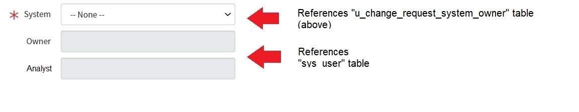

I have been working on several on-change client scripts to make this work, but have so far been unsuccessful. The task to make two fields that share the same table populate with their respective values, based-on the value of another field from the same table.
Below, is my script include.
How do I go about writing an on-change CS to make this work?
Thank you!

This is what I have defined in my PDI:
HHave added the fields to the Change Request form:
After flushing the cache, when I change System, Analyst and Owner automatically update.

Do you want to populate owner and analyst based onChange of the system or vice versa?
08-02-2021 12:04 PM
Correct, based onChange of system.
08-02-2021 12:10 PM
Please use the script suggested by Prasad Pagar.
