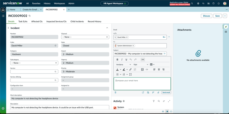

e__b_dinesh4
Hi @VaniMadhuri ,
Here We didn't configure email body field, it looks good in platform view. In HR agent workspace only had some issue look like a "string" field. And system properties are looks fine. I attached the screenshot from HR agent workspace

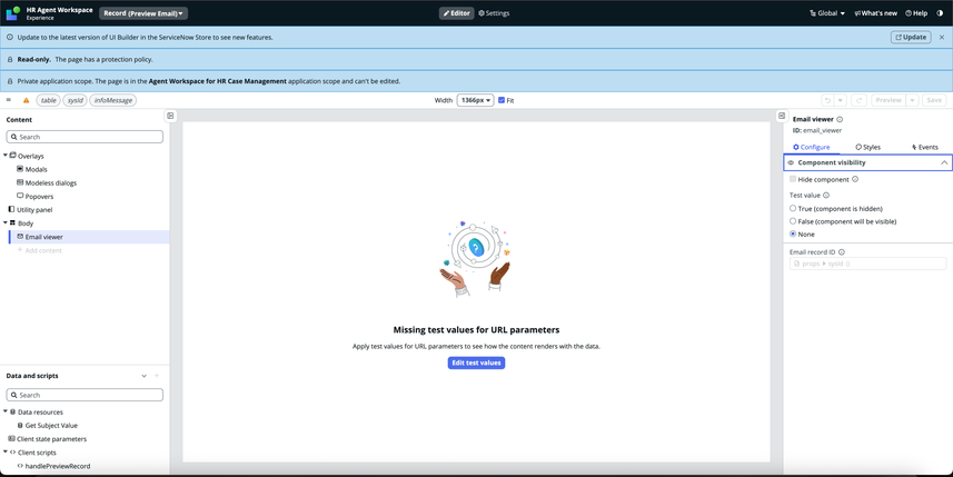

I checked the related page in UI Builder and verified that the email body is rendered through the OOB Email viewer component (now-email-client-viewer-connected).

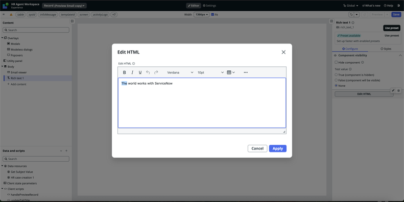

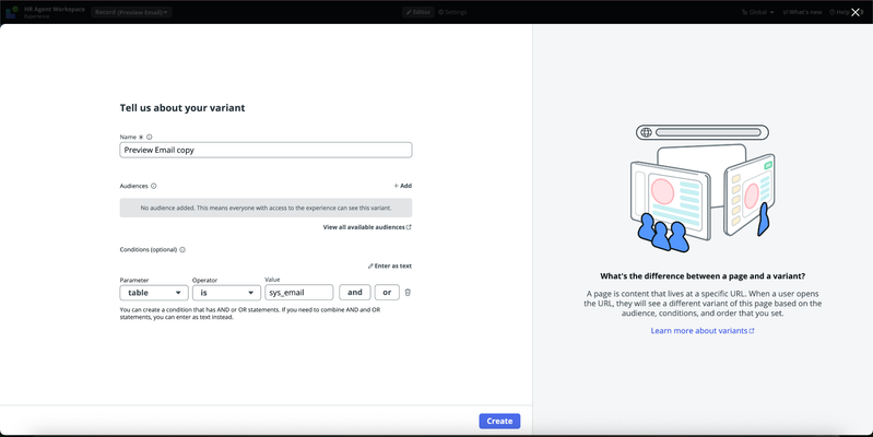

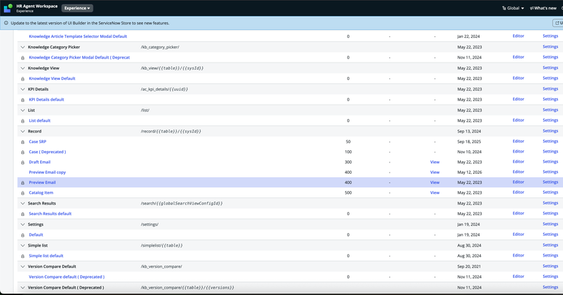

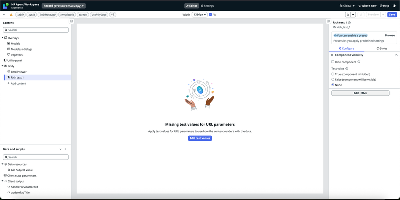

To test further, I created a page variant and added a separate Rich Text component manually. However, you may not find a direct “Rich Text” or “HTML Renderer” setting because the rendering is controlled internally by the ServiceNow OOB component .
The Rich Text component rendered HTML correctly, which indicates that
  • HTML editor configuration is working
  • Workspace supports rich text rendering
  • Issue is specific to the OOB Email Viewer component in your instance
