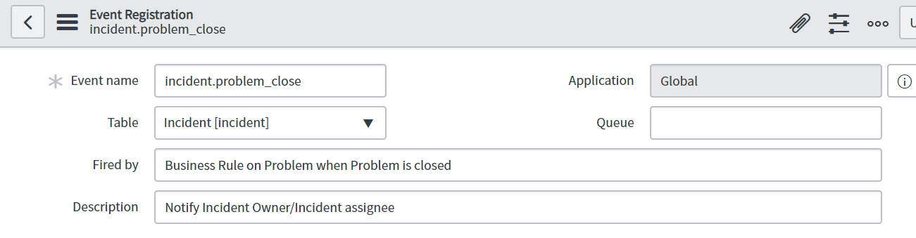

Harshinya1
Mega Guru
I tried below code and it worked.
1. Create an event using event registry
2. Create a notification on problem table to trigger when event is fired and create notification body and subject as per your requirements. Also see who will receive section snippet below for recipients
3. Create an on After business rule on problem table  with condition to trigger when state of the problem changes to closed/resolved
var incidentOwners = [];
var incidentAssignee = [];
var incidentGR = new GlideRecord("incident");
incidentGR.addQuery("problem_id", current.sys_id);
incidentGR.addActiveQuery();
//Can add additional conditions like below based on requirements;
incidentGR.addQuery("state", IncidentState.AWAITING_PROBLEM);
incidentGR.addQuery("hold_reason", IncidentReason.AWAITING_PROBLEM);*/
incidentGR.query();
while (incidentGR.next()) {
incidentAssignee.push(incidentGR.getValue('assigned_to'));
incidentOwners.push(incidentGR.getValue('caller_id')); //Modified Incident Owner field name accordingly
if (incidentOwners.length >0 || incidentAssignee.length >0)
gs.eventQueue('incident.problem_close', current, incidentAssignee.toString(), incidentOwners.toString(), '');
})(current, previous);
Hope this helps

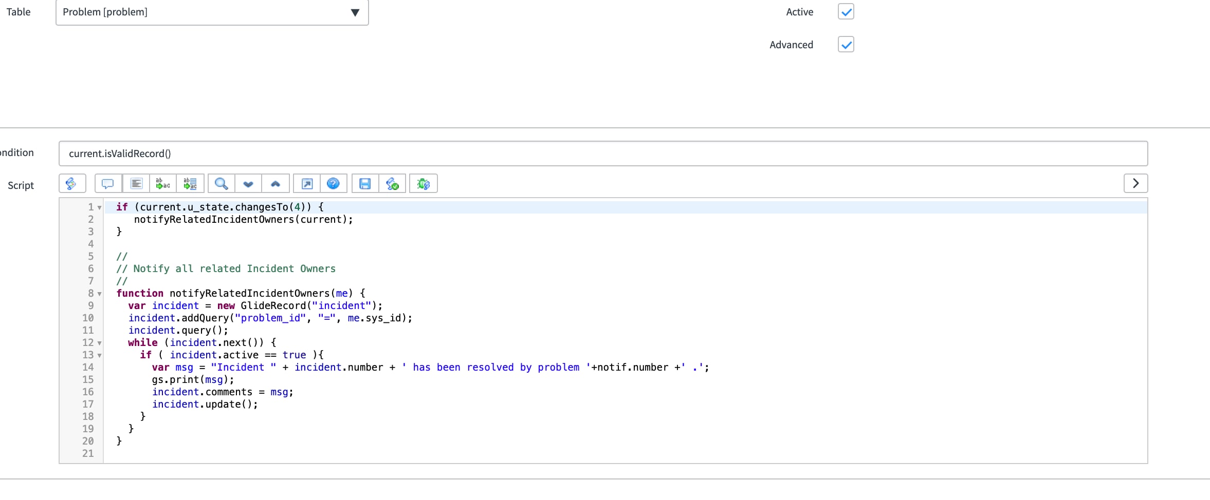

djohnson1
Mega Guru
Adm,
Create an after update BR on the Problem table as noted below:
Condition: current.isValidRecord()
if (current.problem_state.changesTo(4)) {
   notifyRelatedIncidentOwners(current);
// Notify all related Incident Owners
function notifyRelatedIncidentOwners(me) {
  var incident = new GlideRecord("incident");
  incident.addQuery("problem_id", "=", me.sys_id);
  incident.query();
  while (incident.next()) {
    if ( incident.active == true ){
      var msg = "Incident " + incident.number + ' has been resolved by problem '+notif.number +' .';
      gs.print(msg);
      incident.comments = msg;
      incident.update();
Derrick Johnson
Sam179
Created an After BR.
I checked my email logs and didn't find anything. The email is suppose to go to the incident assignee (assigned_to field) and I didn't find any email in the logs.
I have couple questions.
Where is email to assignee being done in the code?
Can you also explain where are you getting "notif" in notif.number from?
Appreciate your help.
Harshinya1
Mega Guru
incidentGR.query();
Hope this helps
Thank you so much. That worked.
